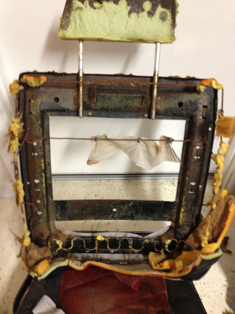

Ok, let's sort this out. Just been out to the shed with a sharp knife and shredded it. Now give me your opinions. Thanks guys. Attached File  ImageUploadedByTapatalk1374883648.872351.jpg   77K   12 downloadsAttached File  ImageUploadedByTapatalk1374883666.563691.jpg   59.91K   12 downloadsAttached File  ImageUploadedByTapatalk1374883682.181001.jpg   92.42K   12 downloadsAttached File  ImageUploadedByTapatalk1374883707.814047.jpg   65.97K   10 downloadsAttached File  ImageUploadedByTapatalk1374883725.396793.jpg   80.05K   8 downloadsAttached File  ImageUploadedByTapatalk1374883755.697504.jpg   103.44K   12 downloads It looks like I'm missing a lot of spring work. I do have a pair of 4 door seats for spare parts. Can these be saved?
Edited by sibhs, 27 July 2013 - 10:11 AM.

Definitely LJ or LC seats Marty.  Pretty sure motor trimmers can buy lengths of replacement spring and bend up new ones to suit.
Boomfunk will know for sure.

yes you can make the springs.. to be hoenst i dont know if it be cheaper to get a different set or use the ones you have.. keeping  in mind what will they charge you for the spring and foam work..
And what would another set cost.. and if you can find
Interesting set up.. id also be looking further and how the bracket at attached to the base.. if it screws on like normal then they were original 2 door seats..
I cant work out what is going on with that head rest..
Yes they are 2 dr seats, you can see the fold forward lever in this pic. The adjustable head restraints have simply been welded to the top of the backrest frame to turn them into high back bucket seats.
Looking at those pics, I suspect the original metal work at the top of the backrest frame that had the holes for mounting the head restraint height adjustment plastic guides has been removed, or these were originally LC low back bucket seats.
Edited by S pack, 27 July 2013 - 12:33 PM.

The holes are still there for the headrests. Just a matter of cutting the welded rods off. Even if I found another set of seats I'd really want new foam anyway so best to rebuild these in my opinion. Boomfunk, if I give the seat frames and new seat trim covers to an upholster can they generally work with that? Need to repaint and zinc the visible bits before retrimming.

I would suss the trimmer out first.. some of the things i seen around the place.. do as much work as you can.. it will save you.
I understand they have the 2 door brackets.. but that means nothing in hill billy world.. they cut and shut things.. oh ive seen it, ive had some here that were cut and shut.. brackets are correct but just be sure that you can see where it screws to the base that they are like factory
Also find some photo's on the net of really good ones and print them out and take the photo's with you and tell them they need to look like this..
alot of people bring me photo's and it helps when there is no pattern to go by and no foam...

Thanks Boomfunk, totally stripped the seat and it looks factory. I'll get/take photos and also leave a four door seat for reference and parts. Cheers Marty

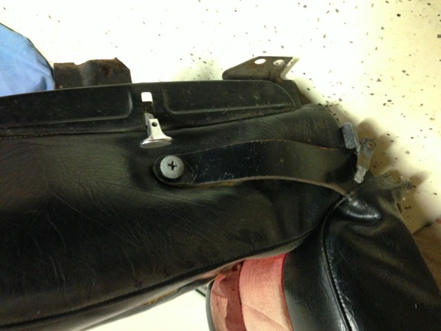

One more question. Are these bolts ment to sit flush?Attached File  ImageUploadedByTapatalk1374910558.212781.jpg   55.56K   6 downloadsAttached File  ImageUploadedByTapatalk1374910575.119416.jpg   47.06K   7 downloads

no they dont , they need room to tilt , cheers
