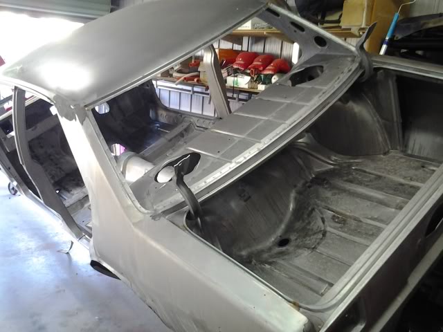

Finally got my shell back after being cleaned.
Looks good, time to start the rebuild.

Nice! Doesn't get anymore honest then that!
Are you going to get yr panels treated the same way?

Yeh the dipping process shows up all the hidden secrets
Next step is to hand her over to my mate who's gonna perform miracles with body work and paint

Yeh panels done too they really come up clean inside and out
