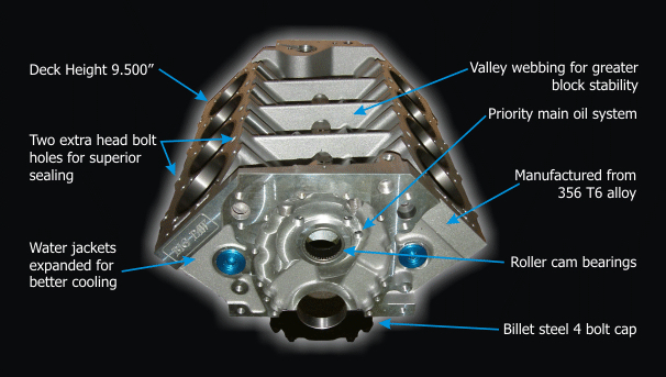

Need a powerful engine for street and racetrack,
look no further than the 'Little Paw' engine block, made from cast iron,
and has beefier cast iron around lifters, extra 6 head studs, bigger cam tunnel,
4 bolt mains, better cooling, better oil delivery, two deck heights,
3-4 times thicker cylinder walls than GMH factory blocks:-
http://www.torque-po...e_paw_block.htm
More info here:-
http://www.aussiev8....lock-specs.html
some quotes taken from other media.

Looks like aluminium to me.

yes, had me wondering about that too Laurie,
shiney, alloy machining marks and reflection, hmm.  :furious:
Maybe that is the fine tuning.
#4 N/A-PWR
  • 9,636 posts
Posted 09 March 2016 - 03:53 PM

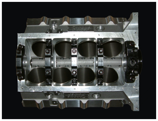

Just noticed the webbing in the alloy photo's up there ^^^,
verses the non-webbing in the cast iron ones.
So we have two versions then?

Top looks iron, lower looks alloy.
2 different blocks?
Where's the webbing in the top one?
Snap Dave.

They have thicker decks, thicker bore walls, more meat around the rear main.
Available in 4.0inch all the way to 4.125 i think.
They are iron, but heard they were looking at an alloy version or may have prototyped one.
Can use standard heads or the torque power heads with extra head bolts.
These guys have done a fantastic job designing and building these.
I Think they can be taken to 440cubes.
All standard holden bolt on ancileries fit.
