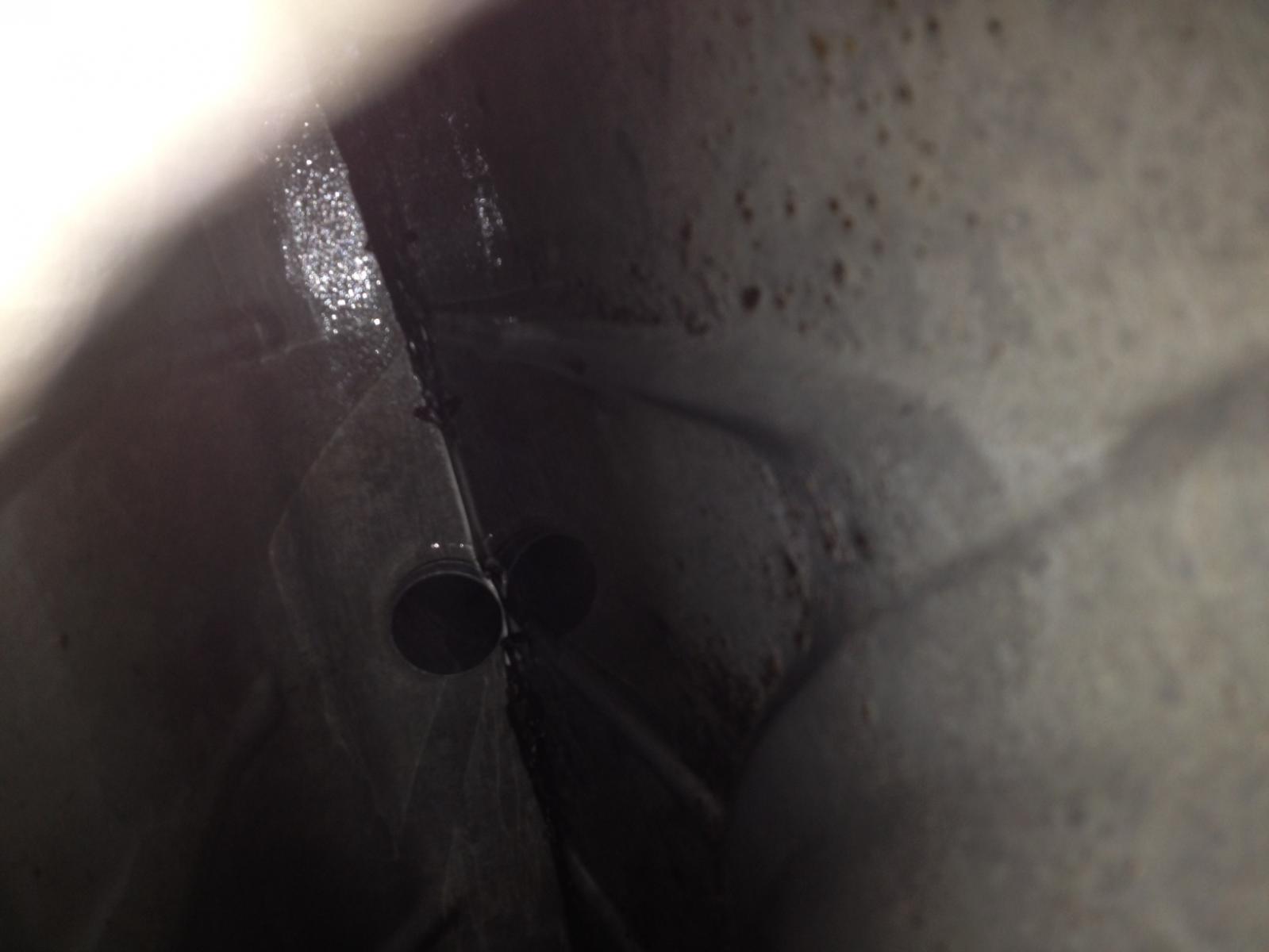

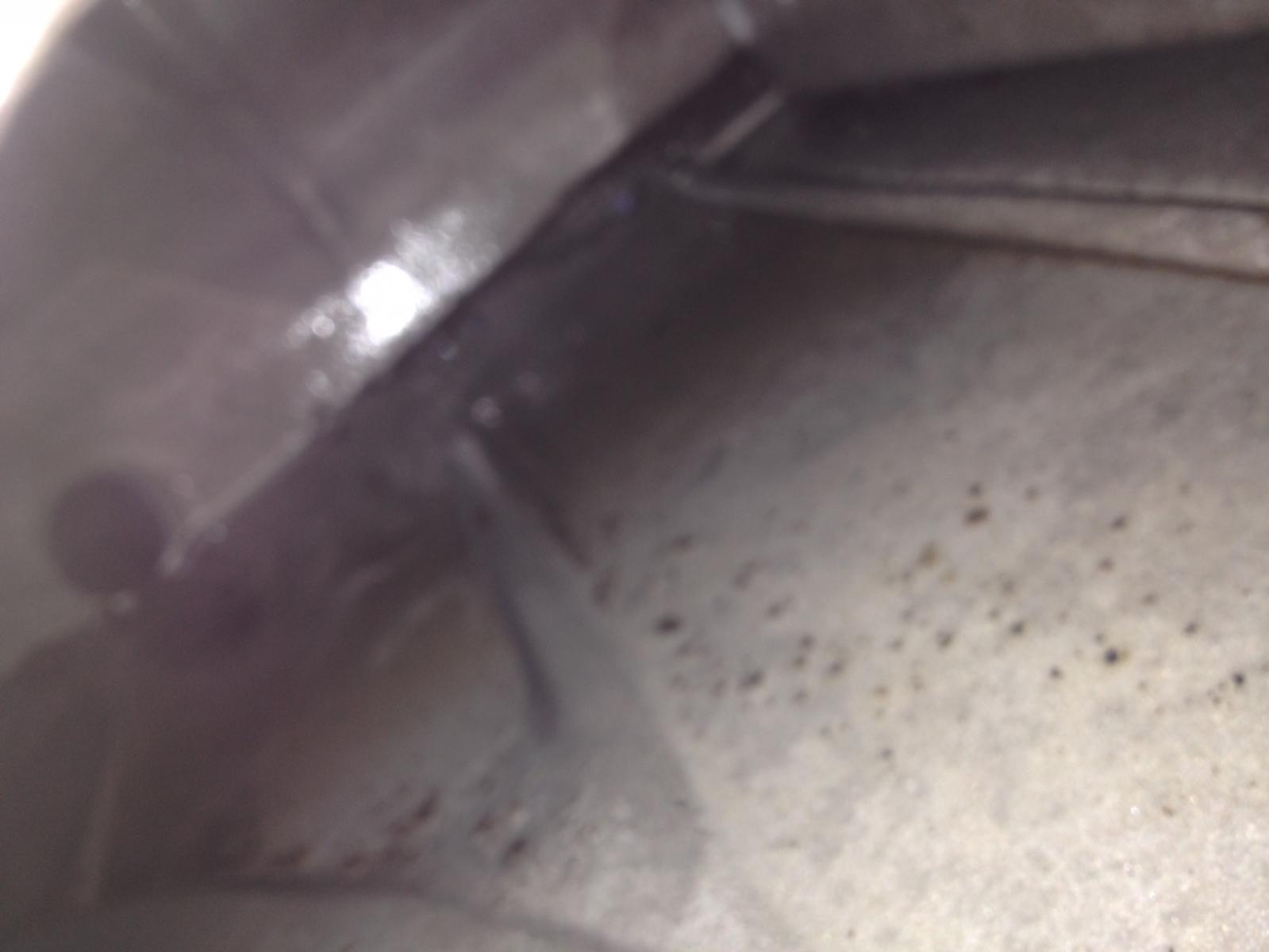

Got a tank need to clean out so can weld tank sump & few other mods...the insides of tank covered in 2-3 mm sticky gum residue probably from fuel additives.
Filled it water then purged tank twice..lasted about a day before fume smell came back obviously cant weld it in case of a 'boomski'
Looks like crap you see on top of an old varajet carby except coated whole inside tank,never seen it one that bad.
Anyone ever had same issue?
