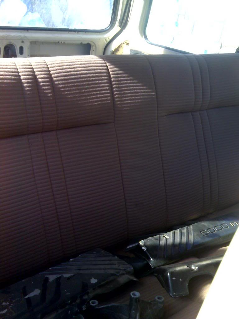

and this is the VH which donated the 5L to my torry, such a nice commodore to do that. The commo is in pretty good condition but there is a bit of rust on the rear, and the rear bumper is dodgey. Interior is pretty nice. In a couple of days ill put the 253 into it.
