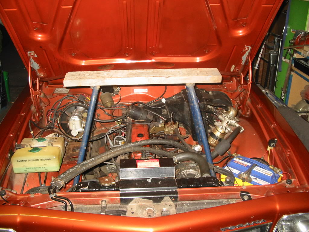

Hello ended up making an engine lifter based on the wooden horse principle.Thought I should do it to keep the forum OHS officer happy and also to stop fom dropping my engine on the ground.Used my old useless spring compressor bolts to supply the lifting force.Cost about $40 to make- Chuck :spoton:

Posted 12 August 2008 - 10:30 PM
OOOH clever dick, that's nice :spoton:

Thats brilliant chuck, patent pending? :D :spoton:

Yes , very clever. I used similar setup with old spring compressors and couple of bars to press my bushes into suspension arms.
I dare say you could do the same with your new tool.
