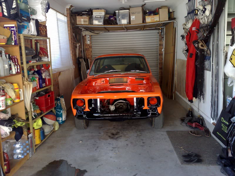

#104 orangeLJ
Posted 17 September 2009 - 08:42 AM
Well back from the panel shop last night, all prettied up and hi-filled.
Definitely looks different already!
Had the front section repaired too, its going to be re-blacked all the way out to the edge of the indicators.
pictures- (still sitting on the trailer, as its off to the paint shop tomorrow at lunchtime)
