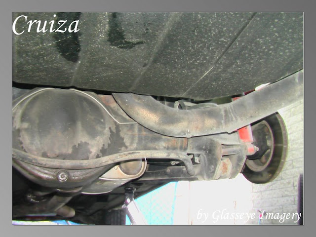

Well you would be wrong go directly to jail do not pass go do not collect two hundred dollors
My Hatch with 9in diff and sway bar and 3in exhast over the diff no knocks no rattles fully loaded or empty
(took the guy all day to do from extractor to tail pipe 3in all the way bar the very front twin 4in down to twin 3in then single 3in mandel bent no squashed or kinks

Might be just me but is that 3"???
Looks like a kink next to the shock?
The real question is WHY?

That's well done Cruiza although I would probably ask the same questions as above, and it depends on the definition of a kink - I wouldn't be happy with bends that tight, did it get very hot?
Also Mumstaxi has a good point, more room in a UC
Compared to the shockie id say yes 3", I know what you mean tho, 3" does not look that big these days (so my misses was telling me, LOL), i think due to all the spanka's fitting the 4 & 5" Cannons you seem to see on everything ! :o

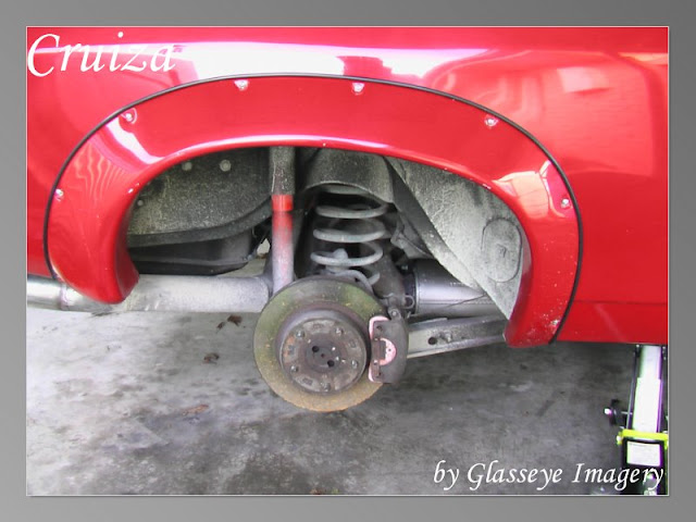

A little off the topic , from the photos the rotor looks like it is vented ( not solid ) ???.
If so, what are those brakes from, ??
I'm still to have a diff made up , and will be running rear disks, just exploring my options.

Yes that is a 3in pipe (just call me a lair why don't you)
The guy that did it for me was Graham Valintine, he did exhasts for a formula one team for a few years, you might say he knew his stuff!
As to the why I had it made up.
A single 3 in pipe flows 15% more then a twin 2 and a half system

In answer to question on brakes I was useing a line lock, multigrips on rear brake hose
rear brakes are ford rear caliper off XB GT same as diff and holden hq front rotors
