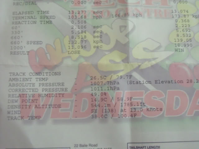

went down the drags last night, ran a 13.2 first run. Hit the limiter in 2nd but was still the fastest time i got on the night. was running car just as i would on the street, didnt even let tires down till later to try and get a little more traction. i reckon its got a 12 in it with a bit more practice, and i didnt even launch it, just fed on slowly in first and manuallly shifted due to p.o.s t700 box short shifting in D. Its pretty adictive but, cant wait to get down and have another go
tyres were nexen 205/50/16 on front and 245/45/16 on back, would like to maybe invest in some MTs, but pretty sure next run headlight, passenger seat and subs will all be coming out, and try get my 60' time down to sneak it into the 12s

new pb, been a while since i been on here, did a [email protected]
