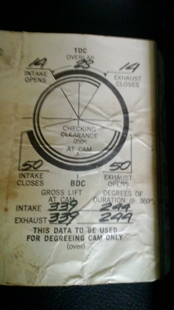

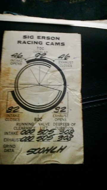

What can you guy's tell me about this Cam...    Thx in advance  :)

Looks to be pretty lazy.
