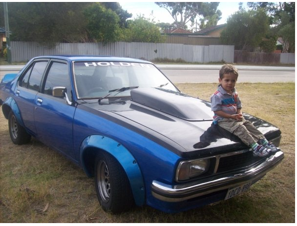

Couple of pics of my UC. Havnt posted before hope they come out alright. Has 15 inch simmons FR rims. Might give you some idea how your might look with 15s and flares.Attached File  IMG_5329.JPG   296.24K   24 downloads

Thats the look Burty, how wide are those rear tyres? and where did you get that front spoiler? It actually fits nicely...
