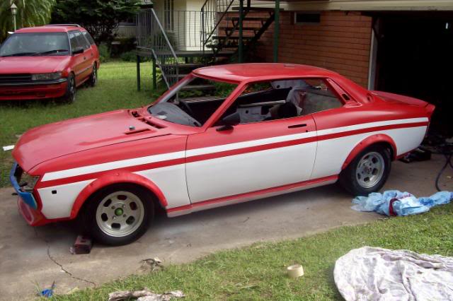

Our '73 Celica started off as a FREEBIE from Mt Gravatt BUT we saw there was potential in the old girl yet !
THESE PICS FOLLOW A 6 WEEK BUILD TIME !
Was sad n tired & just needed some love
WHEW...

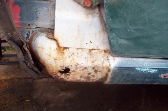

37 years worth of paint + re-sprays had to go

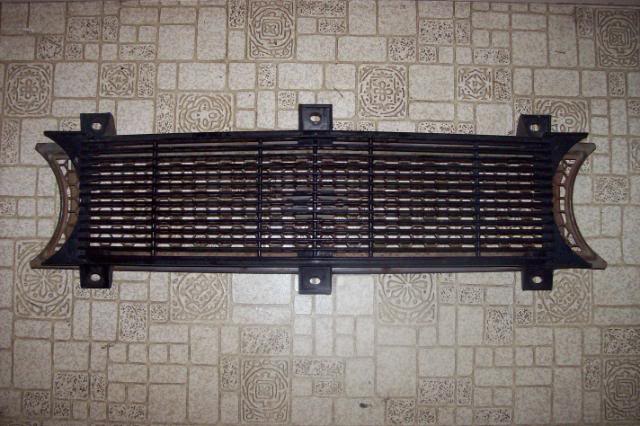

Next came some fun with a '76 grille to fit into a 73
Overlaying it with an LT one
Trace a line
A few seconds with angle grinder
And BAM

Starting to make sense now & all stickered up like "back in the day"

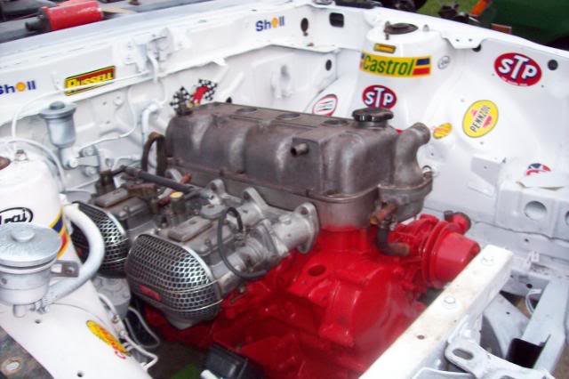

Barn find? - Barrow find!, reco'd 2T with cam that came with another 22
New HD clutch off another motor = FREEBIE

Side Daft goodness on a 2T

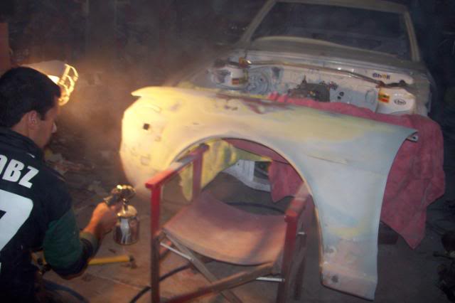

Andrews 1st go with a spray gun

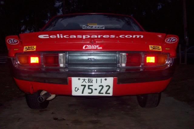

Stickered up
https://cache.gmh-torana.com.au/i606.photobucket.com/albums/tt142/toyboyracer/latestracecarpics009.jpg
https://cache.gmh-torana.com.au/i606.photobucket.com/albums/tt142/toyboyracer/latestracecarpics007.jpg
https://cache.gmh-torana.com.au/i606.photobucket.com/albums/tt142/toyboyracer/latestracecarpics006.jpg
https://cache.gmh-torana.com.au/i606.photobucket.com/albums/tt142/toyboyracer/latestracecarpics005.jpg
https://cache.gmh-torana.com.au/i606.photobucket.com/albums/tt142/toyboyracer/latestracecarpics008.jpg

DONE... :clap:
https://cache.gmh-torana.com.au/i606.photobucket.com/albums/tt142/toyboyracer/28bits007.jpg

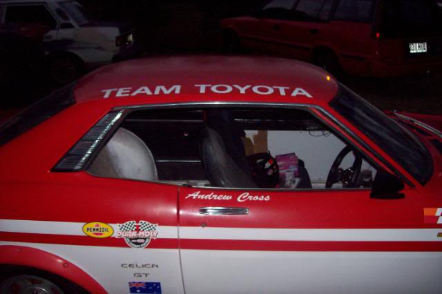

Finally got off my arse & put the seats in today = More racey (not ricey) I hope
Andrews learning the ropes
Wheel stands with no motor !
Genie extractors that came with the car
Panel work begins
Me helping out old school style...
Prepped now paint - Should have let Andrew do this (DOH) = Bad Dad
Paint 101 - Edges 1st
https://cache.gmh-torana.com.au/i606.photobucket.com/albums/tt142/toyboyracer/gtgrille124.jpg
https://cache.gmh-torana.com.au/i606.photobucket.com/albums/tt142/toyboyracer/gtgrille126.jpg
https://cache.gmh-torana.com.au/i606.photobucket.com/albums/tt142/toyboyracer/gtgrille127.jpg
CHRIST!!!!
Fixing this is a nightmare!!!
Anyway.... Getting there!!
#13 Tiny
Tiny
  • 10,018 posts
  • Name:Tiny
Posted 02 November 2011 - 06:38 PM
Next was some serious ride height reduction !
Discliamer: Not for "road use", built for dirt sprints
Original thickness of Kings spring vs thickness off HD Kings spring that were "lowered" via grinder
Note that the HD springs are 15/20% thicker than the standard lowered springs
I'm a firm believer of fish oil & Tectyl to prevent rust
Spay it, brush it ECERYWHERE
Removed all door glass for lightness
Encase trunk/boot area for fire hazard
Who said '70s flares are out ?
Put in a SW-20 MR2 seat
Start taping it all back up !

If it is the same blue one, I helped him pick it up from somewhere up at Gatton - it had a 2TGUE in it with a microtech controller - geesus christ it was fun and geez that was a long time ago.
I have cut and welded more rusted lower guards and sills out of TA22s than I care to remember back in the early nineties. Once those weatherstrips go on them, that's it the rust has them in no time.
Talk about a challenge welding those thin panels.
