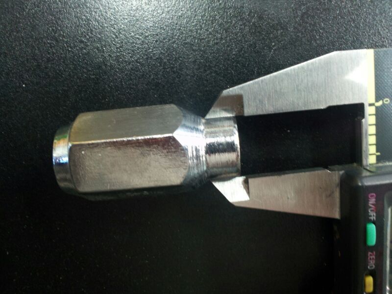

#21 8d11p
8d11p
  • 115 posts
  • Name:8d11p
  • Location:FNQ
Posted 14 July 2013 - 08:39 PM
Attached File  image.jpg   63.7K   13 downloads
Hoping this size does the job. If it does it will work out cheaper that having 4 rims drilled out to take the 17 mm nut. I'll post the result for those with the need to have smaller nuts.
