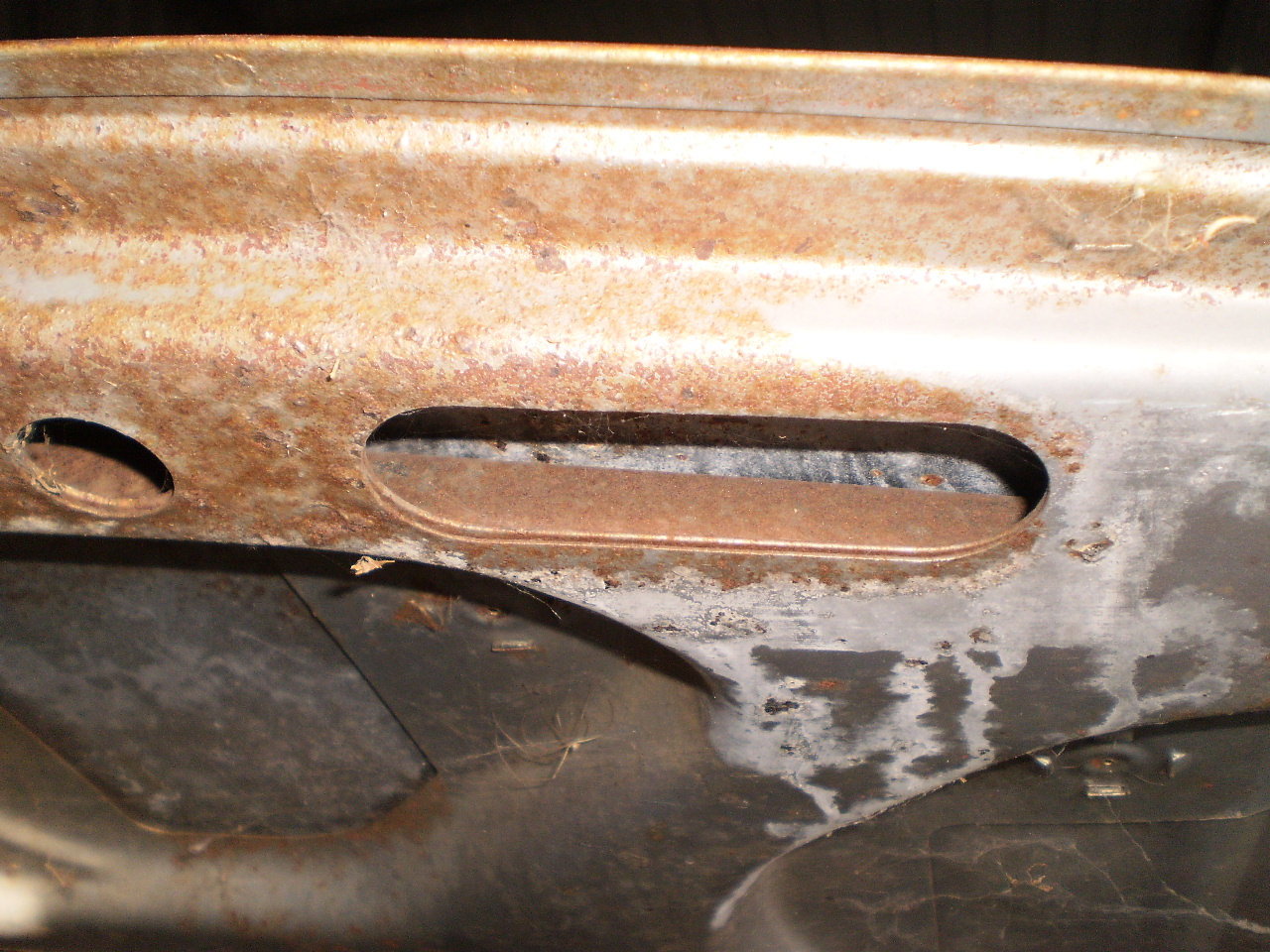

#5 dattoman
  • 16,487 posts
Posted 09 October 2014 - 10:23 PM
4/74 LH
Attached File  P1030049.JPG   572.52K   19 downloads
4/76 LX
Attached File  P1030050.JPG   614.07K   18 downloads
Both double skin (front bit)
Otherwise the bonnets interchange
