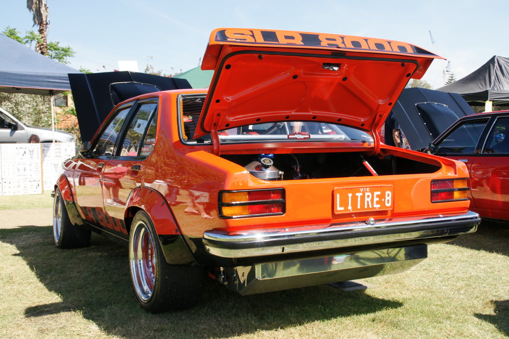

Posted 02 March 2015 - 10:03 PM
Maybe its just me but the top picture in Mint Julip's post above definately shows the tyres do bulge out from the rim face, the rim lip is obscured for over half its circumference.
