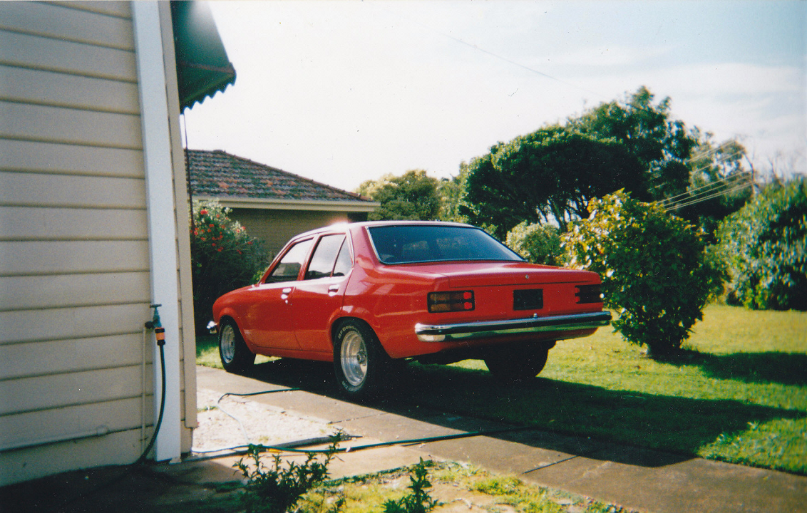

my old ride  had 14x7 with 245 tires, stock diff length & springs
Looks awesome. What rims and offset are these wheels
