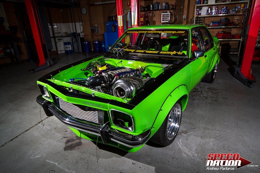

Hey guys, cars is off to the panel shop in 2 weeks, getting excited!
I need help choosing the best paint.
Im going to go Mint Julep green with SLR5000 blackouts.
What brand of paint best matches the original Mint Julep (and paintcode please), and what is the name of the black paint for the blackouts called again?
Thanks in advance
Thats not my car obviously, but i love the paint finish!
BTW, that is a weird way they've done the blackouts on that Torana, kind of a hybrid between the sedan and hatch maskings, only they haven't followed the body line at all forward of the doors... can't say I like it much.
Although that is one big-ass hair dryer, must sound like a jet engine when it gets spinning!

Also went square corners. You can't judge the colour by that pic as it has been enhanced by the photographer. Mint Julep is a little milkier than that pic shows.

Cheers, yes i know the photo has been enhanced . The blackouts are shit on that car also, i was just using the pic as basic reference!
