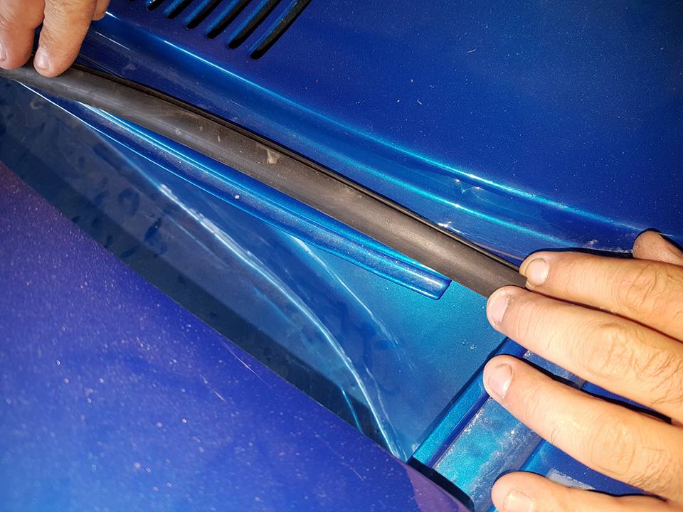

Hi guys . Which is correct fitment for the
bonnet lace below.
Attached File  15267918_1425006980861825_5963132498378899522_n.jpg   76.68K   18 downloads
Attached File  15284059_1425006984195158_3185033086564249079_n.jpg   91.7K   16 downloads.

I'm guessing bottom pic.

Mine is like the top picture

Some say Adelaide cars have them like the top pic and Brisbane cars like the bottom pic.
Mine is Brissy and installed like in the bottom pic.
I wonder which way Sydney, Melbourne and Perth VAP's installed them?

This guys a mate in Melb area and is taking
it tp Summernats.The Harry Hoo is the same
as top.the early 72 built adel 4dr i have
Is same as top also..so you maybe b right
Dave as hes asked on fakebook and people
adamant that theres was like bottom pic
Edited by madtoranajzedded, 28 November 2016 - 08:44 PM.

My 2 main cars have one each way (will have to check the other 2 now!)
I personally believe the lower pic is the better option as the bonnet pushes down & back on the rubber & tend to frOck it when its fitted as per the top pic.
No idea which is factory tho! just my observations

Adelaide VAP were installing them the wrong way around. :stirpot:

Mine after 47 yrs.i cant turn mine around as
holes will be in wrong spots on rubber.
As in rubber will b too far forward
Attached File  15241310_1459392907423285_8684563551828862288_n.jpg   52.96K   11 downloads
Edited by madtoranajzedded, 28 November 2016 - 09:10 PM.

Top pic in my opinion, lip is designed to stop fluids spraying your windscreen if you blow a hose so lip faces forward.
I think!

Gravity will put debris into gap if facing up,
 so gap at bottom for me. :)
^^^ Marty hit the nail on the head,
 you always hear that about bonnet holes
#12 S pack

Have a gander at any HQ-WB Holden. The bonnet strip (which is basically the same extrusion) faces the same way as the bottom pic.
I think the prime directive in the case of the LC & LJ Torana, if originality is an issue, is where the car was assembled .
If Brisbane then install weatherstrip per bottom pic.
If Adelaide then install weatherstrip per top pic.
Edited by S pack, 28 November 2016 - 09:40 PM.

Top pic as air pressure pushes the lacing up against the bonnet to form a better a seal. I have been told by some the other way around but my original one seemed to fit much better no kinks as per top pic.

Now when you say that,
 a correct bonnet connection will seal in any direction,
 but as we know, bonnet hinges are not the best, dammit.
The weatherstrip on mine is squashed so flat by the bonnet that nothing is going to get past it regardless of which way around it is fitted.
Just been looking at engine bay pics of EJ, EH, HD, HR,HK, HT, HG, HQ, HJ, HX, HZ, WB.
They all have the weatherstrip installed like this.
From memory the FE, FC, FB, EK has it installed the same way too.

Looks like they only done it right for very
short period.silly buggers 🙃

The lace faces towards the plenum,it works like a gutter,keeps the water off the wiper motor and the top of the heater box and keep water from getting behind it also,keeps it dry.I took a photo of mine,not sure how to attach the photo.
Regards John.

Nanna Torana 12/73 Adelaide car
One day maybe drag car 4/72 Adelaide car
Parts car 7/73 Adelaide car
And finally the fast one, another 72, dunno month etc cose its on the hoist & CBF gettin it downRIMG0964.jpg
So 50-50 on mine.  But prefer rear facing. will change the nanna one day.
But no idea what correct
