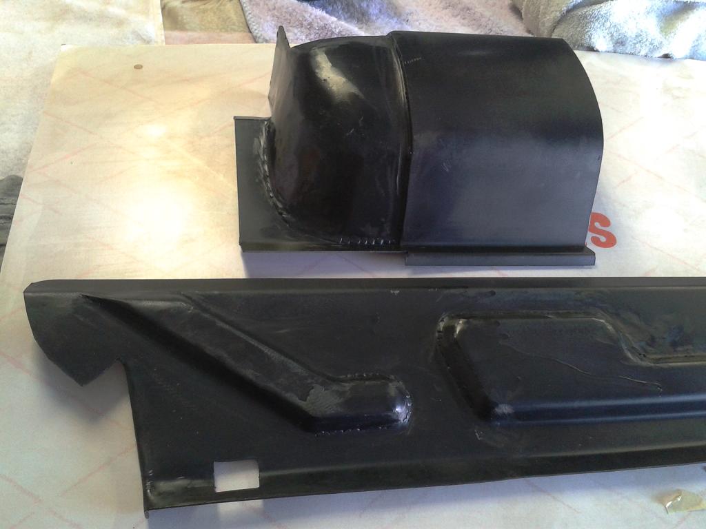

#19 _nips060_
_nips060_
Posted 24 April 2017 - 11:31 AM
Hi I have just fitted one of these on my LJ, I like the fit.
I will try a put up some photos
#20 _nips060_
_nips060_
Posted 24 April 2017 - 12:07 PM
so i hope this works
http://s350.photobuc...kn.jpg.html?o=6
https://cache.gmh-to...4
http://s350.photobuc...s8.jpg.html?o=7
http://s350.photobuc...w.jpg.html?o=12

Hi Chris
You need to copy and past the Image file.
Nice work Chris. Did you hang the door to check the gaps before you welded the new sill on?
Edited by S pack, 25 April 2017 - 09:11 AM.

#24 _nips060_
_nips060_
Posted 26 September 2017 - 08:18 AM
It's been a wile
Yes i did hang the door and had to moved the sill down 2 mm at the front to line them up (that's why the welds look so bad) will clean up some more second time around.
I all so think they could be 10 mm longer at the rear end
but very happy with the sill, it matched my profile front and back
