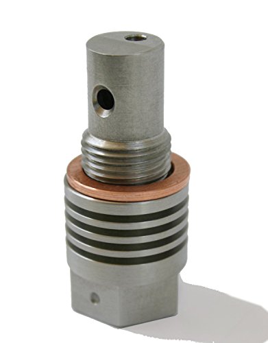

Yeah, I can see how they got confused, I just don't really know what you're gonna do about it?
General rule of thumb is that O2 sensors need to be at least 6~8 inches (150~200mm) after the collector (otherwise they can be spoofed by gasses from only one of the primaries instead of reading the whole bank), but they must be before the cats or at least 18 inches (450mm) before the end of an open header pipe, preferably in a straight section of pipe, and angled downward so moisture can't accumulate in the sensor.
If only installing one sensor in a twin system it should be in the leanest bank, so you would need to do some testing by swapping the sensor from one bank to the other to determine which is leaner. Meaning you need a bung in both sides anyway.
Also, sensors need to run in a certain heat range, too close to a turbo or even just the collector in a methanol engine and they overheat, too far away and they will be inaccurate, although you can buy Heat Bung Extenders which will dissipate some heat, provided you have the space to accommodate the additional length...
One last comment, an absolute no-no is allowing any air into the exhaust system before the sensor, so any cracks in pipes or pinholes in welds or 'slip-on' collectors will cause ultra-lean readings if not sealed.

I've never heard of a Heat Bung Extender. Maybe it will help with my situation. Any idea who carries them?
When I spoke with the tuner, I just asked him quickly where it should go, but I can see I need to go into much more detail.
Regards Mando.
