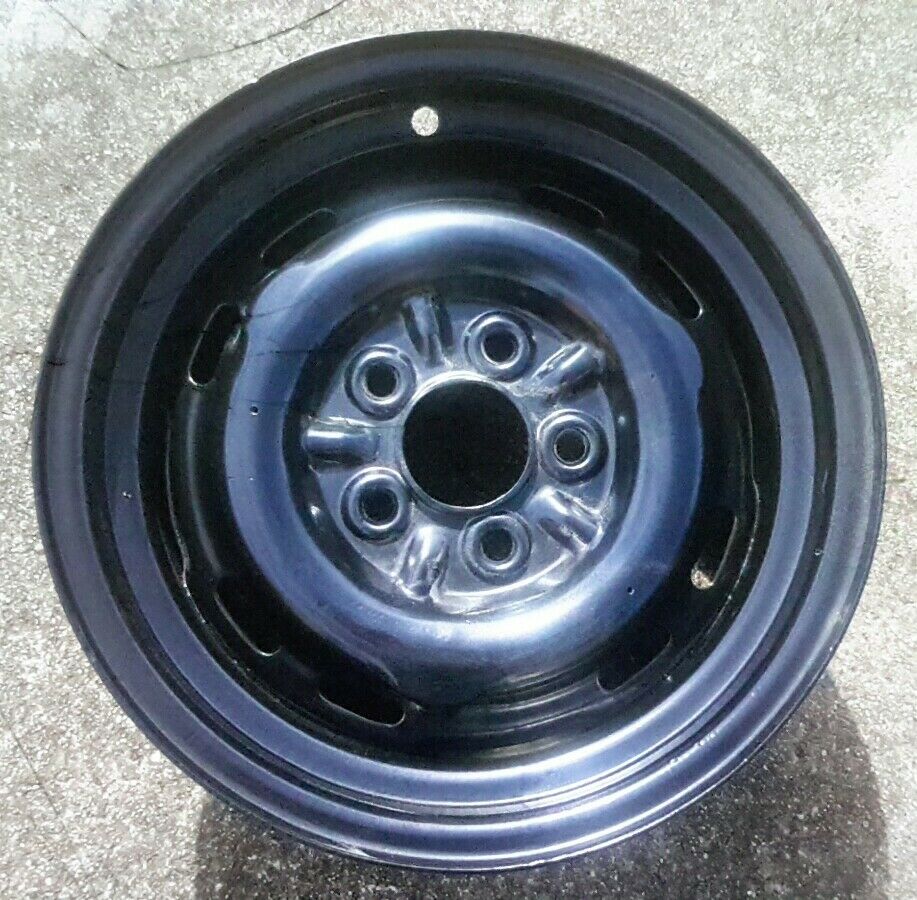

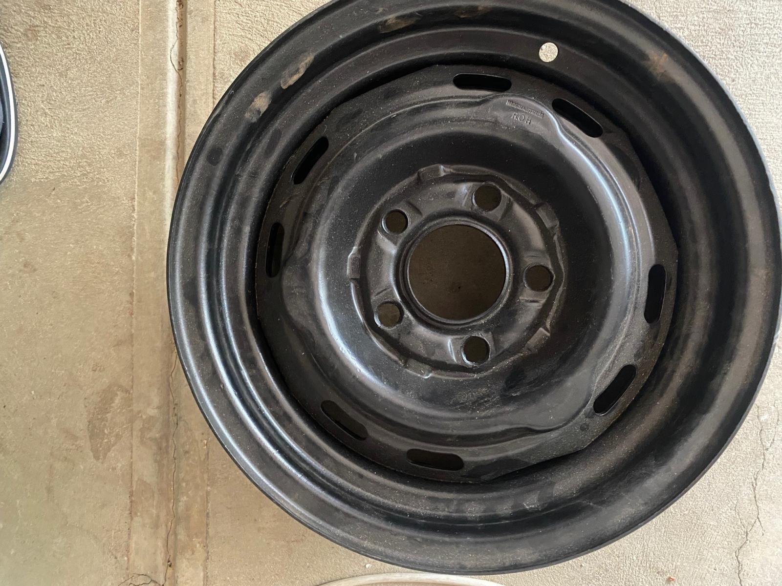

Got some rims with stamp of 5.5JX13 6/72  Holden 22/2 A
Are these from a Torana

hi I don't think the centre is  from a torana     the holes don't look right     looks more like a hk pattern which are 14s      and not enough holes      I could be wrong

I thought there werent enough holes/vents  -date stamp is 6/72 as on the first pic and is 5.5JX   x  13 - is a mystery

hi I know  their not hk rims     I didn't say they were        but has  similar slots x8 like hk      and similar  recess x4 to rim

That wheel looks like its meant to take the GTR centre cap

Due to a shortage of 4.5" rims in mid 1972 the above 5.5" wheel from Rubery, Owen & Kimsley was an interim use on 823 & 825 models only.
Agree, the arrangement of 4 pairs of bullet shaped slots look the same as this HK? rim.

Am I correct that these Toranas thst used these rims were the LC S model  2door and 4 door and the SL 4 door only -but are in fact genuine (used during a shortage in mid 72)
I am looking for rims for an 82911 GTR - the guy I purchased these from assured me they were from a LC Torana (wasnt sure if he was having me on)
Can you tell me is there any difference visually or otherwise in the RIMs used on a LC GTR and XU1 or an LJ GTR or XU1 (barring the Sprintmaster rims)
They may have come of an LC Torana, doesn't mean they were originally fitted to it. The manufacture date tells you those rims were made 6 months too late for LC. The dealer service letter says they were used on 823 & 825 models only. Not used on 82911
