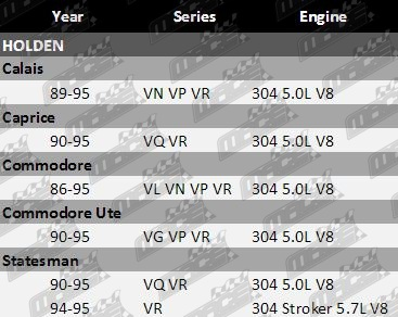

https://www.maceengi...P-VR-304-50L-V8
Due to extended exposure to high temperatures, it is very common for the valve cover gaskets on any motor to eventually become brittle and break, especially on the Holden V8. If the problem is left unattended, the engine bay ends up looking like a mess, worst case, engine damage will result due to oil loss.
This replacement pair of paper rocker cover gaskets perfectly seals the covers to the cylinder heads and meets all OEM specifications. These gaskets have been manufactured from high-grade automotive materials to ensure trouble-free motoring for all applications.
Vehicle Fitment Guide
Notes:
  • VL-VR EFi 5.0L V8s use paper rocker cover gaskets while VS-VT EFi 5.0L V8s use a moulded rubber rocker cover gasket. Unfortunately the cylinder head castings are different with the earlier cylinder head having a wider rocker cover rail. This wider rail does not allow the later rubber type gasket to fit snugly onto the cylinder head and causes the gasket to bulge out of place. This bulging can cause the gasket to be pinched when fitting the rocker cover in place and result in improper sealing.
  • Later model gaskets can be purchased through another ad.
Also this info from Permaseal https://www.aagasket...ver Gaskets.pdf
